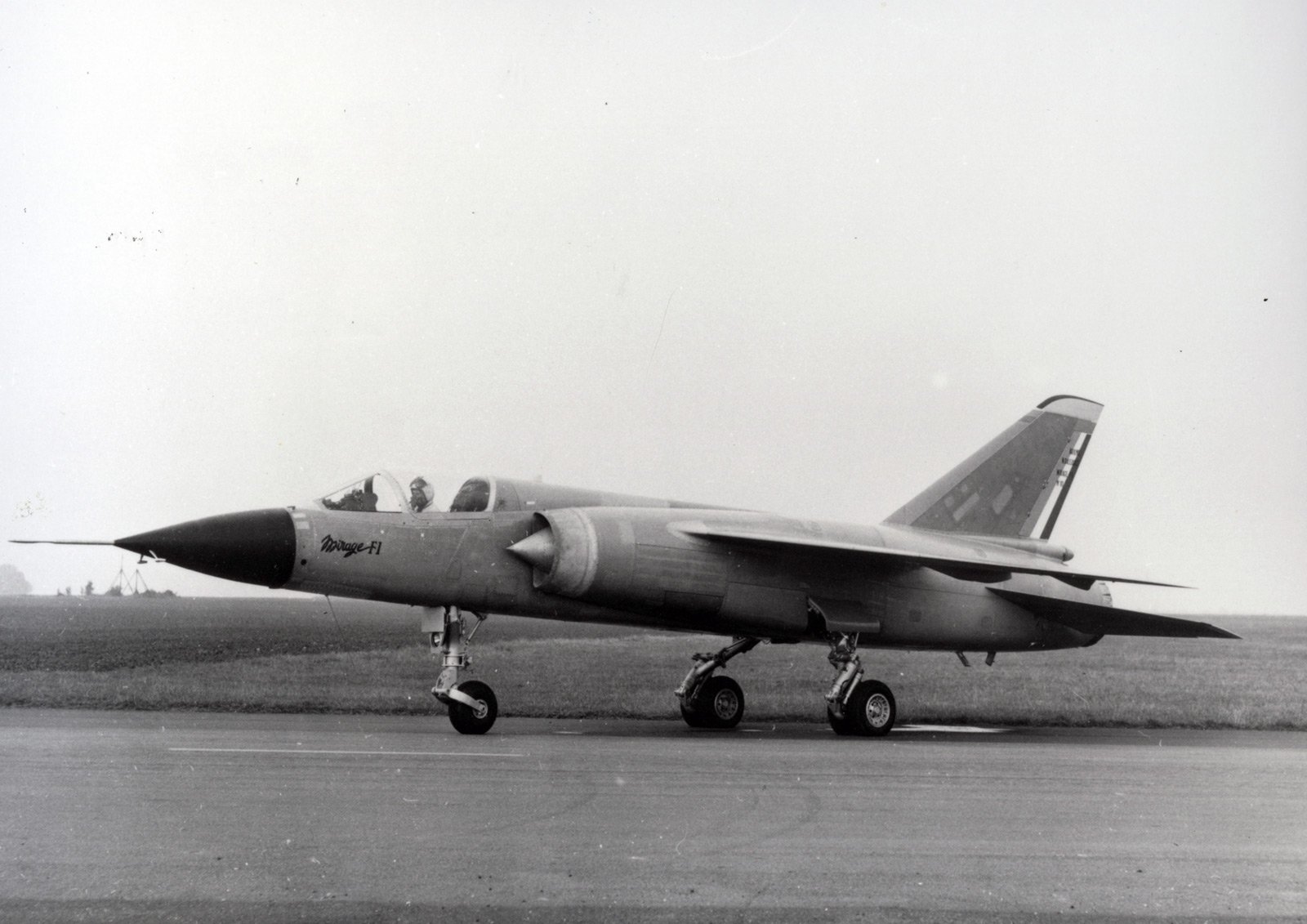

South Africa
From the outset, the Mirage F1 was an export success : 473 aircraft equipped the Air Forces of South Africa, Spain, Greece, Kuwait, Libya, Morocco, Ecuador, Iraq, Jordan and Qatar.
