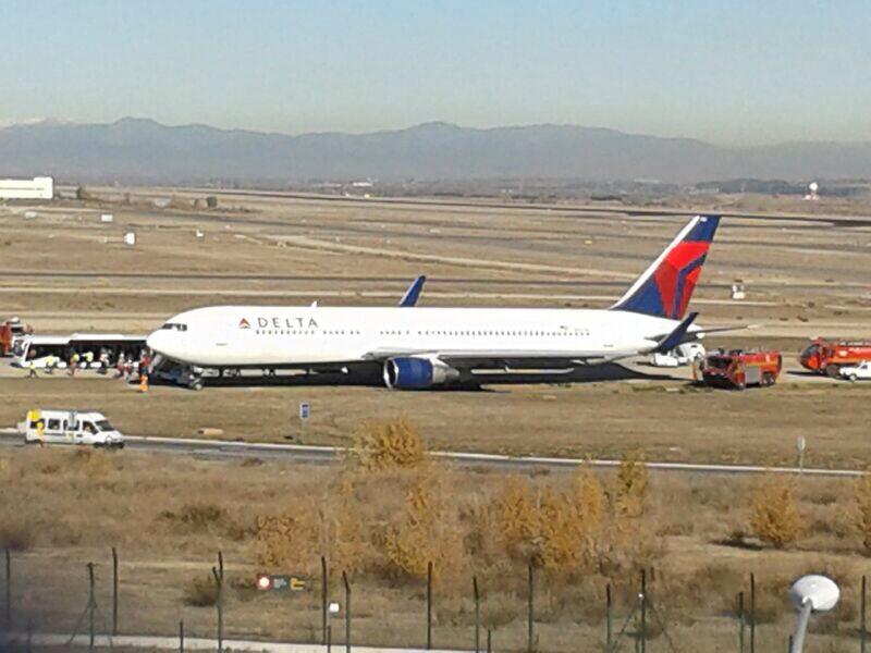

la info disponible sobre el 767 dice que reventó una rueda en el despegue, el hueco del ala sería producido por un pedazo de caucho.
cosmiccomet74
Avherald
Accident: Delta B763 at Madrid on Dec 5th 2013, burst tyre on takeoff, hydraulic failure, taxiway excursion after landing
By Simon Hradecky, created Thursday, Dec 5th 2013 18:32Z, last updated Thursday, Dec 5th 2013 18:32Z
A Delta Airlines Boeing 767-300, registration N182DN performing flight DL-415 from Madrid,SP (Spain) to New York JFK,NY (USA) with 200 passengers and 11 crew, blew the outboard aft right hand main gear tyre on departure from Madrid's runway 36L, the tyre debris penetrated the right hand wing causing damage to electrical (e.g. transponder) and hydraulic systems as well. The crew climbed to safe altitude, performed an alternate gear extension and returned to Madrid for a safe landing on runway 32L about 45 minutes after departure. While taxiing towards the apron, the aircraft veered left off the taxiway and came to a stop. The passengers disembarked via stairs and were bussed to the terminal. There were no injuries, the aircraft received substantial damage.
Debris off the tyre and wing was recovered from the departure runway.
Passenger Ana Arias tweeted that they thought a right hand wheel exploded just as the aircraft was rotating for takeoff, a panel on top of the right hand wing came off. The aircraft returned to Madrid for a safe landing but veered off the taxiway.
The airline confirmed a tyre blew on takeoff, the hydraulic problem is under investigation.
Al reventarse el neumatico, partes del caucho pudieron romper la linea hidraulica de los frenos y perder uno de los sistema hidraulicos por la perdida del liquido del mismo (normalmente los aviones comerciales tienen 3 sistemas hidraulicos independientes).
No creo que un pedazo de caucho pueda pasar del intrados al extrados del ala.

Por ejemplo en el Airbus A320 el sistema hidráulico GREEN es el que energiza el sistema de frenos principal, el steering de la rueda de nariz, la extensión del tren de aterrizaje.
Si se pierde ese sistema hidráulico GREEN, el frenado del avión queda a cargo del sistema hidráulico YELLOW conservando el antiskid pero sin poder utilizar AUTOBRAKE.
La extensión del tren de aterrizaje se debe hacer a traves del sistema ALTERNATE que basicamente es destrabar el tren y bajarlo por gravedad.
Lo que se pierde es el steering de la rueda de nariz, con lo cual luego del aterrizaje el avión quedara en la pista hasta que lo vengan a remolcar con el tractor.
También se pierde la acción del reversor 1 cuando se pierde el hidráulico GREEN...entre otras cosas.
Por eso en el caso de una falla de este tipo se debe entre otras cosas determinar la LANDING DISTANCE requerida con la perdida de todos estos sistemas.
Esto se hace a traves de tablas, aunque también hoy se cuenta con un sistema informatico que te permite determinar esta distancia con las computadoras de abordo (LAPTOP o IPAD).
