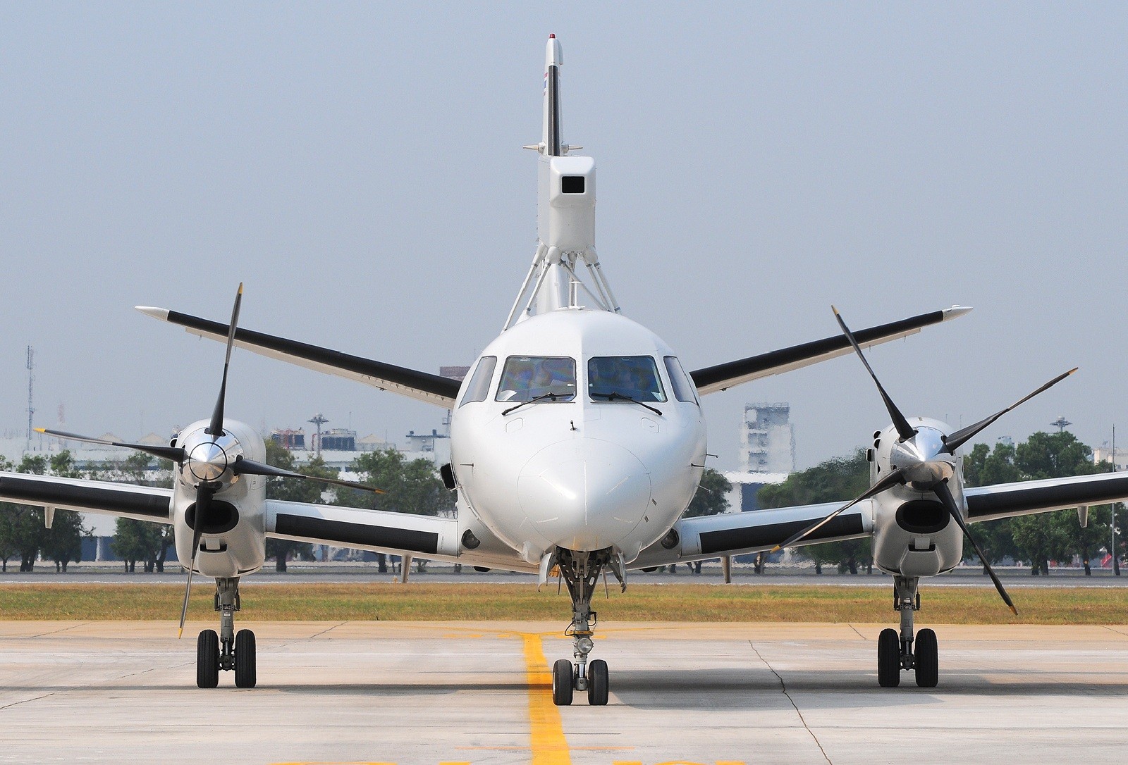

La FAA tiene SAAB-340.
La solución basada en el SAAB-340 ya existe: SB-100 ARGUS con Radar FSR-890 Erieye.
Yo no digo convertir los aviones argentinos sino preguntar por los que está dando de baja Suecia e incorporarlos a la logística SAAB-340 ya existente en la FAA:

In November 2009, Saab announced a 1.5 billion SEK (about $220 million) contract from the United Arab Emirates for 2 of its Saab 340 regional turboprops, equipped with Erieye active-array radars that can scan large airspace volumes, and with related command and control systems. The Saab 340 AEW contract also includes ground equipment, initial spares, and support services.
The UAE is just the latest buyer of Saab’s Erieye system.
Lo veo como una plataforma muy, limitada.
El valor del sistema supera ampliamente el valor de la plataforma.
