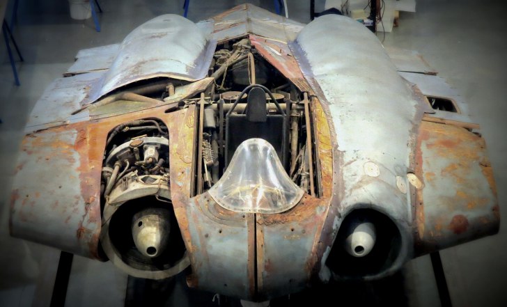

The Horten Ho 229 is known by several different names. The Horten Brothers called the plane the H.IX, so it is often called the Horten H.IX. Reichsluftfahrtministerium, the German Ministry of Aviation, gave the plane the identity Ho 229. At times it is referred to as the Gotha Go 229, due to the German manufacturer chosen to produce the plane, Gothaer Waggonfabrik. According to William Green, author of “Warplanes of the Third Reich,” the Ho 229 was the first “flying wing” aircraft with a jet engine. It was the the first plane with design elements, which can be referred to as stealth technology, to hinder the effectiveness of radar to detect the plane.
The Horten Ho 229 being restored at Steven F. Udvar-Hazy Center (Credits: Cynrik de Decker)

This is the only surviving prototype
