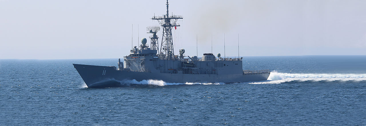

Estuve buscando que tipo de Mk-41 llevan a bordo las Adelaide.
Siempre creí que tenían la self defence de 5,3 metros.
Pero encontré una fuente que afirma que llevan la "TACTICAL" de 6,8 metros.
The ships’ existing Mk13 GMLS pop-up launcher retains its 40 round magazine, but it can now be fitted for more advanced SM-2 Standard anti-air missiles and Harpoon strike missiles (usually fitted: 32 x SM and 8 x Harpoon). An 8-cell Mk41 tactical-length vertical launching system will generally carry up to 32 shorter-range RIM-162 Evolved Sea Sparrow air defense missiles, but could carry different weapons including SM-1/ SM-2s.
Eso abre un potencial interesante de integración de cosas a futuro, si así se lo desea:
VLA ASROC, por ejemplo.
Como se ve el concepto está de vuelta en marinas como la de Reino Unido, donde se apoyan de sonares de baja y muy baja frecuencia remolcados para la detección, identificación y trackeos de plots, los mismos que se operan acá en 2 T-23 (combo Type-2150/Type-2087}.
High-end ASW​
Both the Type 26 and Type 31 frigates will be fitted with Mk41 VLS which offers the opportunity of fielding a wide variety of new weapons. The Type 26 in particular is seen as a high-end ASW combatant but without LRAW and lacking a Torpedo Launch System (TLS), can only prosecute a submarine contact by helicopter. Other uncrewed methods of torpedo delivery are under consideration but a missile-based solution is the most reliable and has many advantages.
Improving sonar and processing technology has increased the detection range of both passive and active sonars but finding and then holding a submarine contact is always a challenge for a surface ship. This is especially hard to sustain if the submarine is aware it has been detected. A weapon that can react instantly 24 hours a day in all weathers and can hit the submarine with little warning and at a good distance from the ship is a very attractive option. The further away from the ship a can engaged the better, even if just reacting to a fleeting sonar contact. There is often great tactical value in forcing the submarine to evade, even if not destroyed. Putting a weapon in the water may force it to turn away or manoeuvre hard, causing the wire guiding a torpedo it may have launched to break.
This category of weapons is loosely referred to as ‘ASROC’ (anti-submarine rocket) after the system developed by the USN in the 1960s. Since the introduction of VLS, the USN now calls the system Vertical-Launch ASROC (VLA). A rocket can quickly deliver a lightweight homing ASW torpedo up to 24km away from the ship. ASROC has been refined over the years, although the basics are much the same.
y
Con esto la Adelaide no sólo tendría un rol fundamental de dar la defensa AAW de zona para la Escuadra, sino que podría colaborarle a las Type-23 en misiones ASW high-end.
RUM-139C
New variant with Mk 54 torpedo, introduced in 2004.
Una posibilidad interesante, en uso en la USN y en las Fuerzas de Autodefensa de Japón, dado que no se han comprado ESSM aún (no se han publicado contratos asignados a contratistas de defensa como suele publicar el Department of War para todo lo demás), y se podría dar uso a algunas celdas de los MK-41 instalados, según misión asignada.
Otra posibilidad podría ser crecer en alguna capacidad de misil de crucero. Desconozco cuales se han integrado que te quepan en un MK-41 "TACTICAL" de 6,8 metros de profundidad (LRASM no porque es muy grande), pero de reportes confiables se sabe que el FC/ASW británico (P-15) subsónico está cerrando en los 5 metros y que ha sido diseñado para lanzarse desde MK-41. En cambio la versión francesa (RJ-10) supersónica mach 3-5 está orientada al muy largo alcance y no creo que lo vendan, ni que quepa allí, ni que sea necesario para nosotros (es overkill). Imagen de referencia de uno y de otro:
Con la versión corta y subsónica (británica) estamos más que servidos: habrá que seguirse el mercado. Pero suena bien interesante.
En cuanto al reemplazo del Harpoon en las Type-23, bueno, ahí la Royal Navy está apostando como interim por el NSM (no en VLS sino en la posición de los actuales SSM) incluyendo sus Type-23 remanentes:
En cuanto a nosotros, no se si podemos seguir ese mismo rumbo aunque no estaría de más tener una munición con un sistema de guia pasivo IIR que combinados a los MM-40 Block III que ya lanzan las M y las Adelaide, configuraría un cuadro de muy dificil resolución para las contramedidas de cualquier adversario (imaginarse ser atacados desde distintos ángulos por salvas de misiles que no puedes asumir con certeza que cabeza buscadora tienen para desplegar el soft kill correspondiente, hasta que ya están demasiado cerca)
Ahí un poquito de las tendencias mundiales y que se podría mirar para integrar acá a medida que los sistemas actuales vayan quedando obsoletos.
