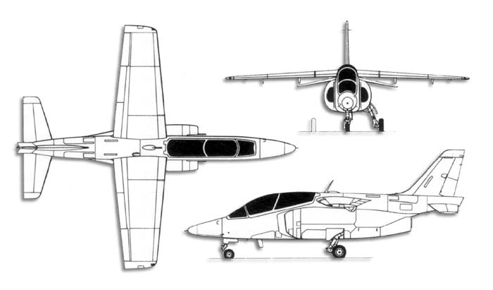

FMA IA 63 Pampa
Origin: Argentina
Type: advanced pilot trainer with combat capability
Max Speed:405 kt / 466 mph
Max Range:1,853 km / 1,151 miles
Dimensions: span 9.686 m / 31 ft 9.3 in
length 10.93 m / 35 ft 10.25 in
height 4.29 m / 14 ft 1 in
Weight: empty 2,821 kg / 6,219 lb
maximum take-off 5,000 kg / 11,023 lb)
Powerplant: one 1588-kg (3,500-lb) dry thrust Garrett TFE731-2-2N turbofan
Armament: provision for a 30-mm DEFA cannon pod and up to 1160 kg (2,557 Ib) of disposable stores carried on four underwing hardpoints Operators:Argentina
