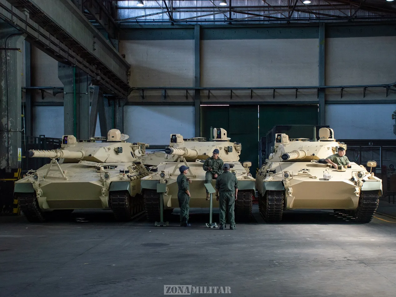

The TAM 2C-A2 modernization and recovery work is divided into two major components: the turret and the hull. Recovery of the latter is carried out by the Directorate of Arsenals, which falls under the General Directorate of Materiel. The refurbishment and overhaul of the hull includes various aspects, among them a new electrical installation, side skirts for additional protection, a driver’s vision system, and more.
For its part, the DGID is responsible for the work on the turret, a modification that replaces and incorporates new technologies: from the stabilization system and electric drive for the turret and gun, to the fire control system, which includes new panoramic sights for the gunner and the tank commander. The turret upgrade also includes a new laser warning system, an internal fire suppression system for the vehicle, an auxiliary power unit, thermal protection for the gun, among other improvements.
It is worth recalling that the modification work and incorporation of turret improvements (equipment basket, various fittings) are carried out by the company IMPSA. As the Mendoza-based company releases the modified turrets, they are fitted with the aforementioned systems at the facilities of Arsenal Battalion 602.
At the same time, work is being carried out on the TAM chassis to restore them to operational condition through the replacement or repair of the various components that make them up. This includes moving parts such as the drive sprocket, idler, and support wheels, in addition to the shock absorbers. “Arsenal Battalion 602 has historically been responsible for performing the highest-level maintenance on the entire TAM family… it has personnel with extensive experience…” explained Major Javier Aguirre, second-in-command of the Battalion.
Within the process, and alongside the DGID’s work on turret modernization, Arsenal Battalion 602 works on the chassis at its different stations. “A team working on a TAM, the first thing it does is completely dismantle it… There are parts that are purchased new and reinstalled. There are parts that are restored… Similar work is carried out on the electrical system, fuel system, engine system… the hull is fully recovered…” Major Aguirre told ZM.
