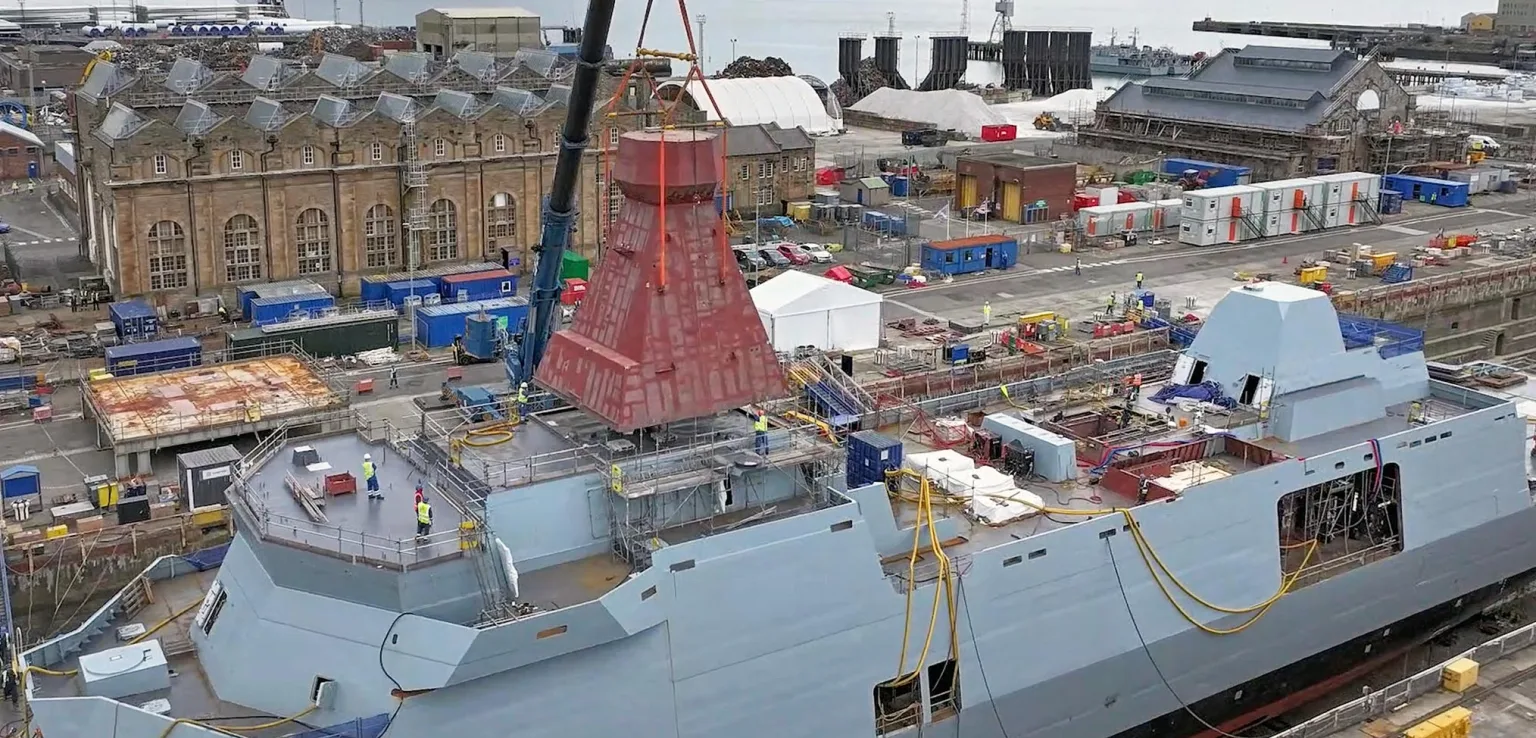

As part of the Royal Navy’s surface fleet renewal program, the frigate HMS Venturer, the first of the new Type 31 class, has reached a major milestone with the installation of its integrated mast. The operation, carried out at Babcock’s Rosyth shipyard, marks a decisive step in the ship’s fitting-out phase, providing the essential structure for the integration of advanced sensors and next-generation combat systems.
The mast, weighing 24 tons, was manufactured at the Rosyth complex and subsequently moved to the dock to be lifted and placed onto the ship’s structure. With this addition, the vessel’s profile is now almost fully defined. Unlike the Type 26 frigate, whose main mast is made of composite material to reduce weight, the Type 31 uses a simpler steel superstructure, which will serve as a platform for radars, electronic warfare systems, and electro-optical equipment.
Among the systems installed on the mast are the Thales NS110 air surveillance radar, the Terma Scanter I-band navigation radar, as well as antennas for the Royal Navy’s new Radar Electronic Support Measures (RESM) system. In addition, it includes the pedestal for the Mirador Mk2 electro-optical system, ensuring that HMS Venturer will be equipped with a comprehensive sensor suite for surveillance, air defense, and maritime domain awareness operations.
